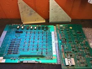

Midway's 8080 games all have a two-PCB set -- a smaller daughtercard plugged into the larger motherboard in an "L" shape. The most common cause of graphics glitches (invaders with lines through them, shots leaving trails and such) is a bad connection between the two boards. Try cleaning the connectors and reseating the boards.

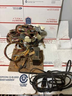

Bally Midway Space Invaders Deluxe Arcade Wire Harness & Transformer
Auction ends in: 1 day, 4 hours
